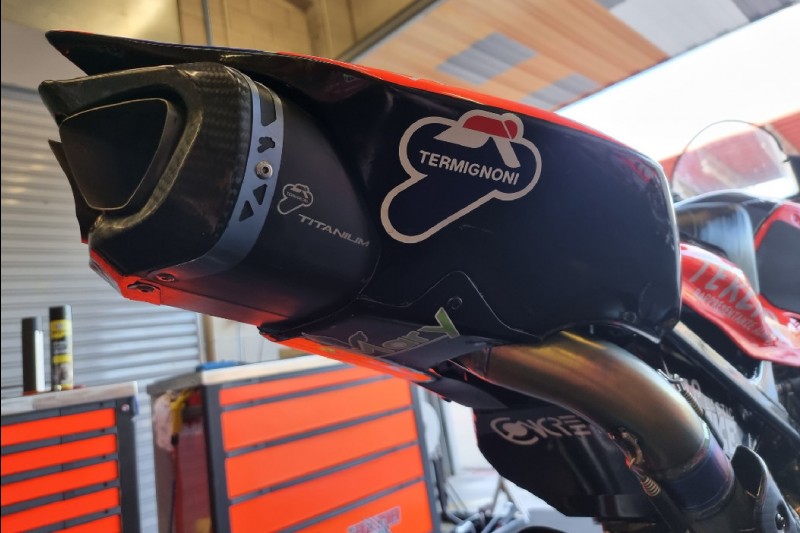

#808634 Είχες και πριν την αλλαγή της εξάτμισης σημάδια; Αναρωτιέμαι αν θα μπορούσε να υπάρχει κάποια σύνδεση. Είναι τεράστια επιστήμη το θέμα της εξάτμισης γι'αυτό και με προβληματίζει και αυτό.
Στα World Superbikes, όλες οι Ducati τρέχουν με Akrapovic ενώ μία τρέχει με Termignoni και υπάρχει αρκετή κουβέντα πάνω στο ζήτημα.
Termignoni vs. Akrapovic: Ducati looks interested in the data from Motocorsa
https://de.motorsport.com/superbike/new ... 3/6913569/
Ducati equips its machine tools with exhaust systems from Akrapovic: Motocorsa relies on termignoni and thus arouses the interest of Ducati engineers
After Gigi Dall'Igna moved from Aprilia to Ducati, not only the MotoGP project in Borgo Panigale took a new course. There were also some changes to the Panigale project in the Superbike World Championship. The factory Ducatis have been equipped with exhaust systems from Akrapovic since the 2015 season. The factory team had previously been supplied by Termignoni for years.
A lot of movement has been seen in the subject of exhaust systems in recent years. The V2-Panigale was initially equipped with an under-engine silencer. Akrapovic surprised at the end of the 2015 season with a system that resulted in an outlet under the rear and, thanks to its longer manifold, tickled more power out of the engine of the 1199.
Later, the specialists developed a system with two outlets under the rear in collaboration with Ducati, which was used until the end of 2018. An Akrapovic system with outlets under the bow is used in the V4-Panigale.
WSBK 2021: Termignoni and Ducati are reunited
In the past WSBK season, Termignoni returned to the Superbike World Championship with a spectacular exhaust. The private Motocorsa team equipped its Panigale V4R with a termignoni system that flowed under the stern. Axel Bassani was very popular at some events and attracted the interest of the Ducati engineers.
Ducati can also access the data of the customer teams. "We share a lot of information with our satellite teams. At the same time, there is a deal that allows us to evaluate their data. This gives us information and we can see what needs to be developed with a view to the future, "explains technology director Marco Zambenedetti in an interview with 'Motorsport-Total.com'.
The customer teams can obtain current factory material from Ducati. At the same time, the private Ducati teams have the freedom to replace some components and thus use their own sponsors and partners.
"We have to provide them with a reference, but at the same time give them a certain amount of leeway so that they can work on the motorcycles with their technical partners," says Marco Zambenedetti.
Ducati recognizes differences in performance
But what are the concrete differences between the different exhaust systems? "We recognize a small difference," says the Ducati technology director. "It is interesting. But we also have to take into account the differences in the driver, such as his size."
"It is not easy to draw concrete conclusions," notes Marco Zambenedetti. At Ducati, however, one always tries to use the experiences of the private teams as inspiration. "There are internal meetings and reports. We bundle all the information and then determine which direction we are developing, "said the Italian.
Aruba.it Ducati Panigale V4
Motocorsa Racing
H Akrapovic αγαπάει πολύ το τιτάνιο, η Termignoni το τιτάνιο αλλά και τα ανθρακονήματα. Προσωπικά, βρίσκω πιο όμορφη την δεύτερη.

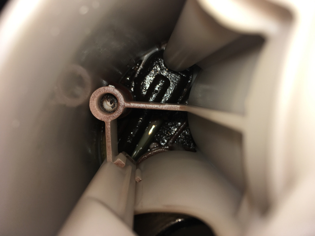

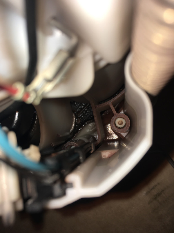

#808726 Παραθέτω φωτογραφίες από την δικιά μου αντλία. Υπόψιν και με πρόγραμμα και χωρίς τα ίδια κοψίματα μου έκανε και έβγαζε και βλάβη Σταρτ στοπ και με τα δύο file.
#808762 Ωραίος. Είναι μέγιστη μπούρδα να κατηγορήσεις ένα πρόγραμμα για μια αντλία, τη στιγμή που αυτό έκανε σωστά τη δουλειά του. Αναρωτιέμαι δηλαδή πόσος όγκος ασχετοσύνης υπάρχει σε αυτά τα γκρουπάκια του Viber. :s_whiteflag
Η πλάκα με του Θανάση ήταν το πριν και το μετά. Δεν πιστεύαμε πόση διαφορά έκανε το αμάξι όταν ανοίξαμε!
Δεν είμαι το πρώτο αμάξι που ελευθερώνει καταλύτη και μεγαλώνει το downpipe. Ειδικά σε αυτά τα αμάξια.

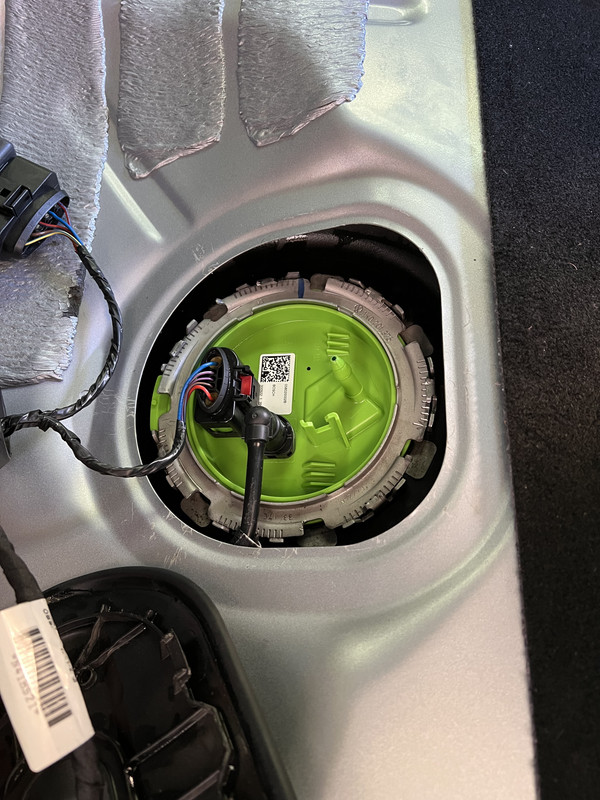

Κούμπωσα μόλις τη νέα αντλία. Βγαίνω μια Σχιστό να πατήσω και το αμάξι κόβει. Έκανα ένα σκανάρισμα πριν και βγάζει το σφάλμα N290 πάλι προφανώς.
Έχει και ένα εγκεφαλάκι η αντλία. Να είναι αυτό; :hmmm:
